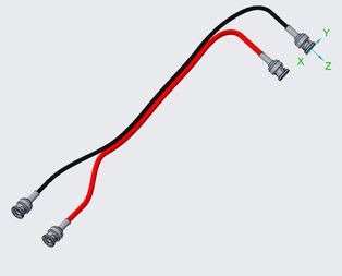

How to have Cable with different Spools in a Harness?
See Image attached. Green and Yellow need different spools. Spool option to change is grayed out for YELLOW. If changed for GREEN, Yellow also changes.

Hi, This is exactly I am stuck at. I cannot change my spool for the other two cables that follow the first one. I can change for the first, but it changes for all in the cables done in that Harness.

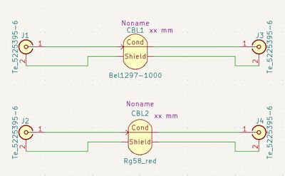

You probably have a different version of creo? Attached is the simple test assembly (Creo9) I used. Two Spools and two cables. I can't actually change the spool for any cable after it is routed. But if I first delete the cable then I can make a new cable with a different spool. In the sample below I deleted Cable1 and routed it again with a black spool... the new name is Cable3 (in component coax_test.prt).
If you use a logical file and you made changes to spools or connections then you have to use the "Update"-menu option until it shows that nothing to update anymore. I have noticed that many times I have to delete cables and spools before the "update" says that everything is OK (update-regen-delete-update-regen-delete).

I see. That can be frustrating especially if you route manually. I do even the simplest cables with schematic. With logical files and networks you can quite easily delete your routes and regenerate the cables with new spools or connectors. Cable names and connector refdes values always stay to the ones you have specified on your schematic.
