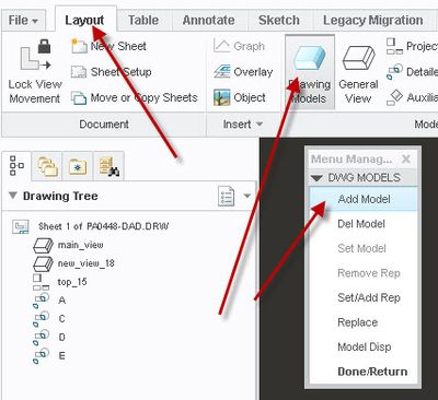

You will still need 2 assembly models. The first one is for welding. Then you make another assembly for machining that contains the welding assembly (only 1 component in the machining assembly).
Make your drawing of the welding assembly, then add the model of the machining assembly and you can detail the machining in the same drawing.
To add the second assembly to the drawing, go to the LAYOUT tab, select DRAWING MODELS, then choose ADD MODEL in the menu manager.
