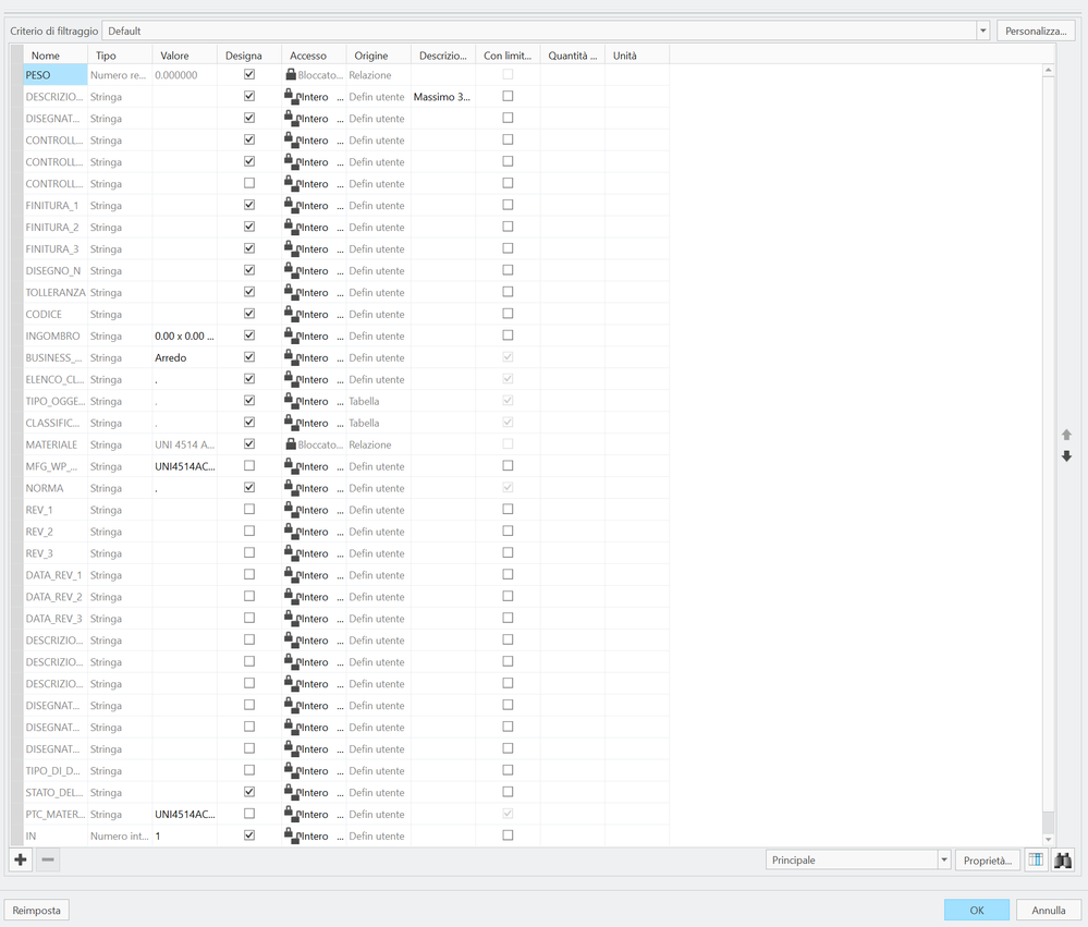

I tried, but maybe I formulated a wrong question. We suppose to start from a part file. I set my units from file->prepare->model properties. Now inside the tab I have many units (mm for length, kg for weight etc.)
Now my question is, how I can set in my start part a relation that or a parameter that change automatically, when I choose the units, and that with a string i can load in a frm file?
So the start of my question is in start part to set units parameter that change automatically, so I can write the command with &<units> in carthage to obtain an autocompilation of it.

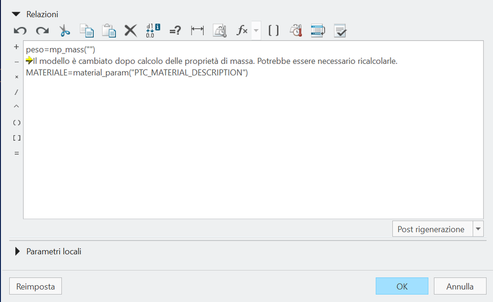

 In the relations tab there is a relation to obtain the units?In the relations tab there is a relation to obtain the units?
After the relation in the first picture the unit parameter will compare here in parameters tab like a string valueAfter the relation in the first picture the unit parameter will compare here in parameters tab like a string valueand finally I can write it in frm file inside carthage with & before nameand finally I can write it in frm file inside carthage with & before name
Obviously the unit parameter inside the parameters tab will be a string data and not a number.

In the answer is wrote: &asm.mbr.ptc_unit.UnitsLength, but the correct string to insert inside the carthage is:&mbr.ptc_unit.UnitsLength
So in relations tab I checked the Units sensitive and the I adding a new relation inside post-generation called .
This had create a new parameter inside parameters tab that is locked. And at the last time using the string that I write above inside the carthage the units is automatically write inside it and when the units change it will be upload after rigenerate automatically in each drawing.
