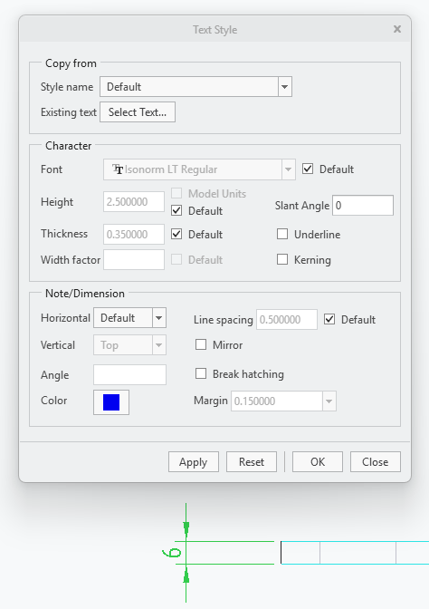

Is there a way to rotate the dimension text by 180°?

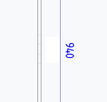

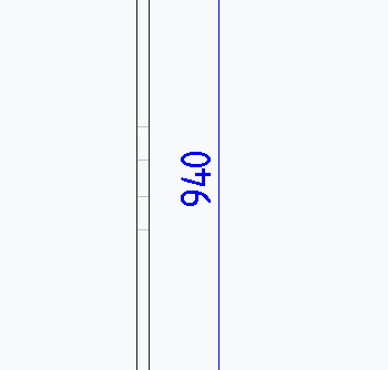

This is what I mean:
Old:
Rotated 180°:
I saw someone suggest to rotate the view 180° in a previous post but this does not work for me.
We are currently working with Creo 10.
Kind regards,
Jaime

i think it is not possible by config or dtl options.
The only way if the dimension line not vertical but a little bit slanted counterclockwise for example 0.1 degree
Then dimension text will be oriented automatically as you want

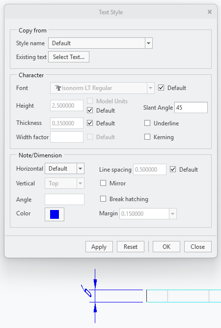

I tried the following based on your suggestion, but I don't get the solution I'm looking for.
Perhaps I'm doing something wrong, so below some images to show what I tried.
Is this what you meant?
Kind regards,
Jaime
Please see the attached video
I meant dimension line slant, not dimension text slant
This seems to do the trick! Thank you 😊
