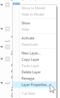

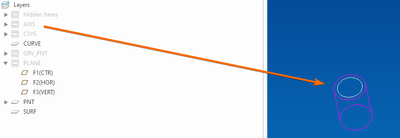

How can I show the thread (of a threaded hole) when the axes are hidden?

If you set your view to "wireframe", you should be able to see the thread, like this (note that AXIS is hidden):

If when axis is hidden, you do not see the thread, maybe somewhere hole feature or thread is defined to be in the axis layer. You can check that by opening Layer Property of AXIS and remove related items or rules.
