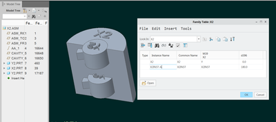

Second issue is related to renaming objects.  And you addressed what happens when parts are renamed, and I think that you demonstrated how the assembly family table will be updated even when not in session - when using Windchill.  But this is about renaming the instances of the parent assembly.
Because when is done, the ref.model column in the family table of the constituent part is not updated with the new name of the ref. model assembly.
Another bug is that "Switch External References to Instances" for some reason fails to create the required family table with the ref. model column.
But it sure seems to me that the "Switch External References to Instances" function works on my Creo 4 system to update the parts family table.
Hopefully these screenshots demonstrate the strange behaviours:

Assembly X2.asm and its family table:
x2_part.prt family table:
x2 part genericx2 part generic
Note old style cut-out is at the bottom of the part and new style boolean cut is at the top of it.

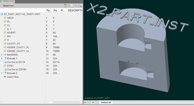

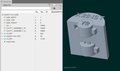

x2_part_inst.prt in the assembly instance x2inst.asm:
Assembly x2inst - note part instance x2_part_inst does not have the cutouts in the right orientationAssembly x2inst - note part instance x2_part_inst does not have the cutouts in the right orientation
Note neither cutout in the X2_part_inst.prt follows the actual placement of component Y2.prt...
2) After using the "Switch External References to Instances" function in X2.ASM family table:
Note ref.model column specifying the assembly instance has been added to the x2_part.prt
Looking at the x2_part_inst reveals something strange:
Assembly instance x2inst - note part instance x2_part_inst does not have the old style cutout in the correct orientation...Assembly instance x2inst - note part instance x2_part_inst does not have the old style cutout in the correct orientation...
(that is kind of weird - the old-style cutout does not follow the placement of Y2.prt)

However, now if I rename the instance X2INST.ASM, then the family table of X2.PRT will not update:
(that needs to say X2INST-A)
Okay, then if I open the family table of X2.ASM and use "Switch References to Instances":
then the family table of X2.prt is updated:
