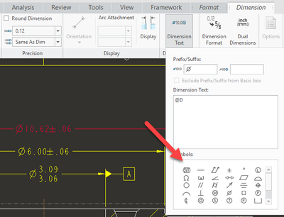

For a dimension, the symbols are in the DIMENSION TEXT selection.

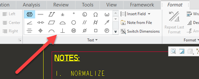

For a note, the symbols are in the ribbon, make sure the format tab is selected

Hey Steve!  It doesn't work for me.  The symbols are greyed out in both the pop-up RMB "Properties" editor and in the ribbon.  It's totally p!$$ing me off no end.  Luckily, I still have my Olde School .txt file where I can cut and paste the ASCII characters in if I have to.  For some stupid reason the symbols in the dimensions work.  Go figure.  If I'd known I'd hate Creo 4 as much as I do I'd have stuck with the option of staying on Creo 3 M180 instead which would have solved my Adobe PDF creation issues.  Gah...

My process for note editing. I select the note (symbol box would be grey), then select within the note where I want to edit (or in your case, where you would want to add the symbol, the symbol box is now active/available).
If I'm making a new note, the symbol box is active immediately.
For an existing note, once your done, you can RMB properties and the old pop up dialog returns and you can edit in that window with the text symbol button available there but in my opinion the ribbon makes it easier (once you figure out the process)
