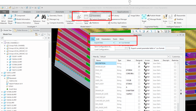

I need to be able to import .xml files into Creo.
SM_9575840
I am using Creo Parametric - Release 5.0 (connected) 5.0 5.0.6.0
I currently only have export capability on my new laptop.
I need to schedule a meeting for Monday 6/14 with PTC & a Meggitt IT Admin
to be able to make the needed changes

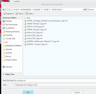

what I need to be able to do is export an .xml file from the Creo 5.0 of one part / assembly file to another.
So you want to add PARAMETERS to a Creo part or assembly?
Maybe you can try Creo Modelcheck to add any missing parameters:
https://www.ptc.com/en/support/article/CS52662
Sadly, I can't help you any further with Creo Modelcheck, as we don't use it.
If it's parameters you are after, you can just copy them from one file to another by opening up the parameters:
Tools -> Parameters
Select the ones you want, and copy them (Control-C)
Open the part you want them in and again go to Tools->Parameters and paste them (Control-V).
Use this all the time to "fix" old files that are not set up properly.

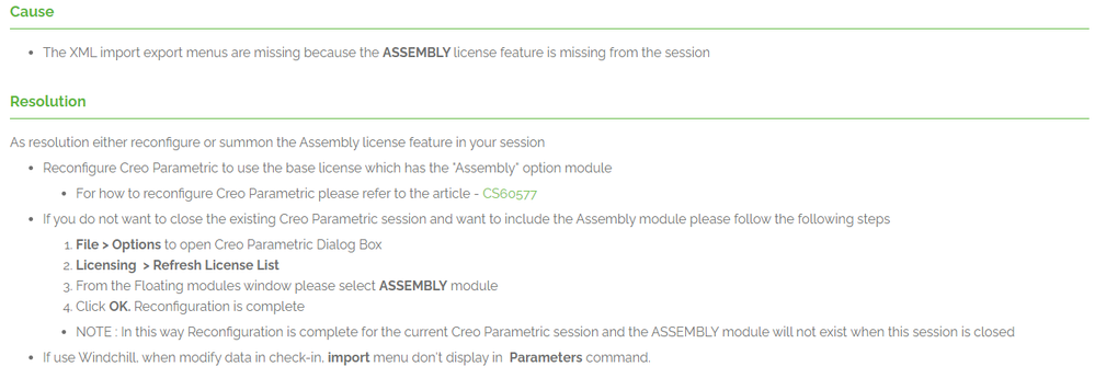

Seems like this article may apply:  https://www.ptc.com/en/support/article/CS303553
