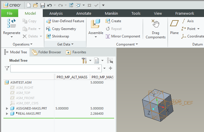

I have a case open at PTC showing inconsistent assembly handling of component mass. See article CS396826.
The problem occurs for a component with no solid geometry and an assigned mass of some value and with 0 for the assigned volume.
I have attached models.7z with a sample assembly (asmtest.asm) with 2 components:
  • assigned-mass.prt
    • model with no solid geom and an assigned mass of 5.0
  • real-mass.prt
    • model with actual geom and mass calculated the "normal" way
  • These models have been created with Creo Parametric 6.0
  • You will need to set config.pro option mass_property_calculate automatic

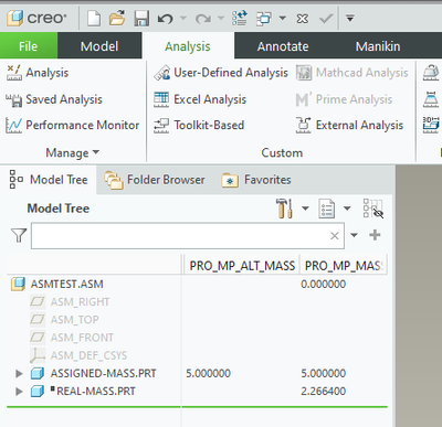

If this is the only component in the asm then it's assigned mass is not used by the asm. Screenshot (Creo Parametric 10.0.1.0) showing the asm mass of 0 when real-mass.prt is suppressed and note the asm has 0.0 even though assigned-mass.prt is showing 5.0.

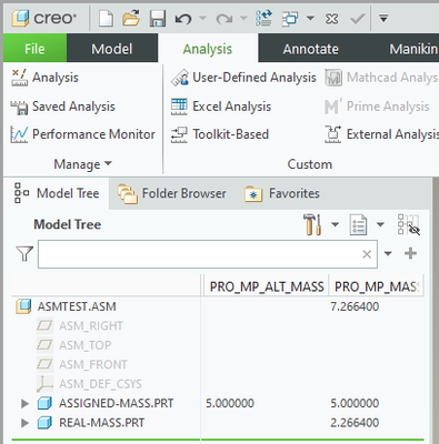

After resuming the real-mass.prt the asm mass now correctly has 7.2664 which is including the mass of the assigned-mass.prt:
So we have shown the asm level mass has inconsistent behavior. I have tried Creo Parametric releases 6.0 thru 10.0 and all have this issue - have not tried any earlier releases. I want to hear your opinions on "Is this a bug or not?"

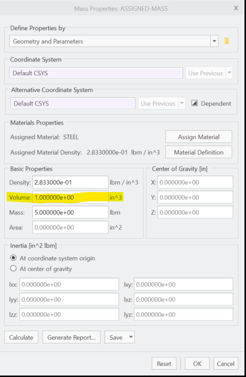

The workaround is to add a dummy volume value to the assigned mass properties which is what we are doing:
After doing this the asm mass now is showing the mass of the assigned-mass.prt as expected. It is using the assigned mass (as I would expect) vs the mass you get from the density x volume:

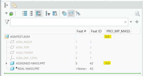

Have you run a report using this config option to verify that Creo is handling the component with assigned mass when getting the "wrong" result?
Set the configuration option mp_calc_level to all_models to include the summary of assembly components, details of assembly components, and the summary of bodies in the assembly mass property report, and the summary and details of bodies in the part mass property report.
Involute Development, LLC
Consulting Engineers
RandyJones
20-Turquoise
(To:tbraxton)
Running a mass properties report shows the same inconsistent values for mass.
Setting mp_calc_level to all_models makes no difference - still shows the same inconsistent values for mass. As shown in POR_MP_MASS and in the mass properties report.

If you add a value to assigned volume the calculations behave as expected, using the assigned mass and not the value you get from volume x density. See below for a response from PTC on how the mass is being calculated.

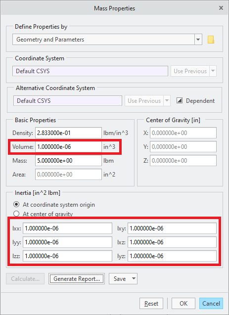

because of the fact that the problem is related to VOLUME=0 I modified assigned-mass.prt as shown on following picture.
Note: I do not know whether it this trick make sense.
Martin Hanák
This is the workaround we are using which is to assign a dummy value for the assigned volume. And like you say this trick does not make sense.
