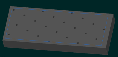

I don't know how to do this with fill pattern in the "base part" and components assembled by reference to the fill pattern.  In this case, each component instance is identical.

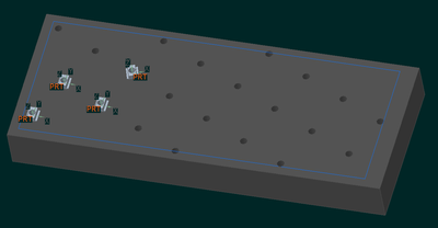

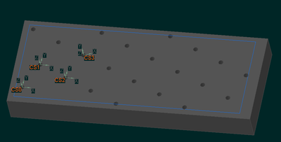

I suggest you create a sketch filled with coordinate systems in the base part and use that as the basis of the component pattern:
1) base part with the fill-pattern1) base part with the fill-pattern

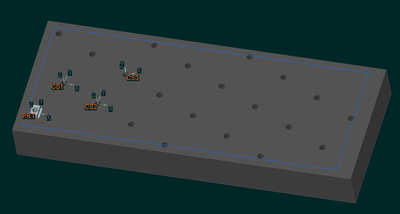

2) "trace" a sketch with coordinate systems, each aligned to the rotation angle needed for that location2) "trace" a sketch with coordinate systems, each aligned to the rotation angle needed for that location3) assemble 1st component to the 1st coordinate system3) assemble 1st component to the 1st coordinate system4) pattern, using point/sketch option, and use the 1st coordinate system as the alternate origin4) pattern, using point/sketch option, and use the 1st coordinate system as the alternate origin
Note that I only traced 4 holes in this example; obviously 100 would be quite tedious.
The traced sketch will have 100 angle dimensions in it, so could be quite a mess to display.

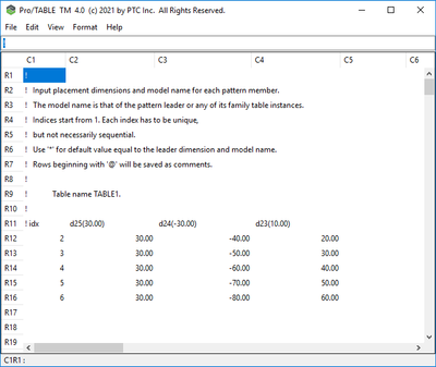

@scampbell wrote:
Too bad we can't make a table and just vary the angle dimension across the pattern or by position.
You can with a Table Pattern...but then you will loose the Fill Pattern ability to follow the shape of a sketch 😕
And the Table Pattern:
The third column is the angle of the coordinate system.
If you constrain your tube to the first coordinate system, you can then apply a reference pattern.
HTH
