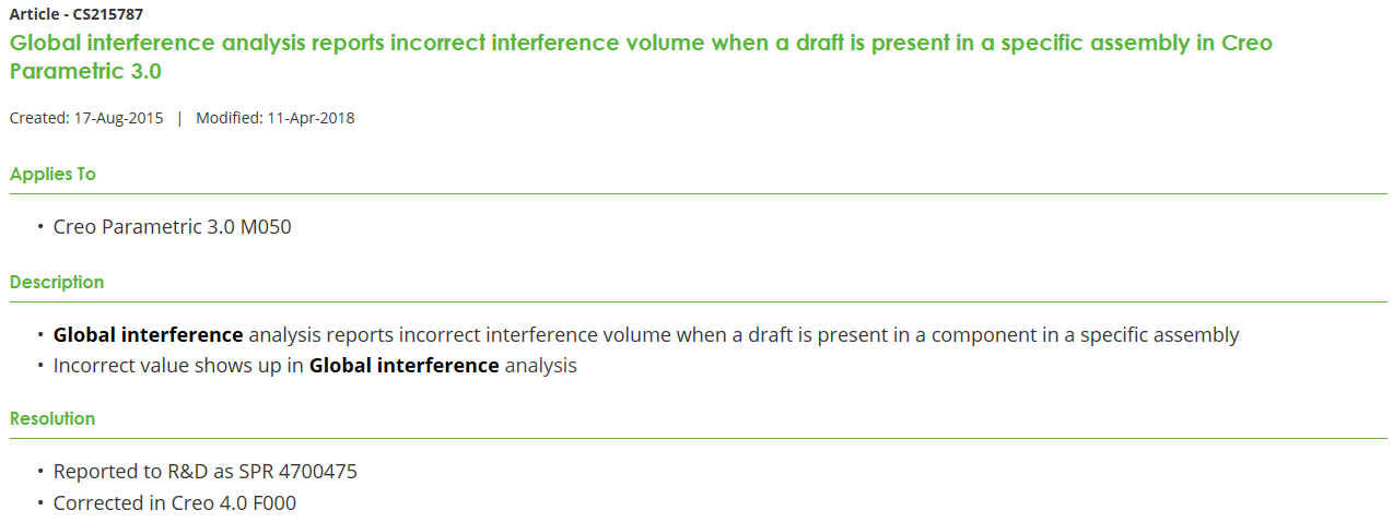

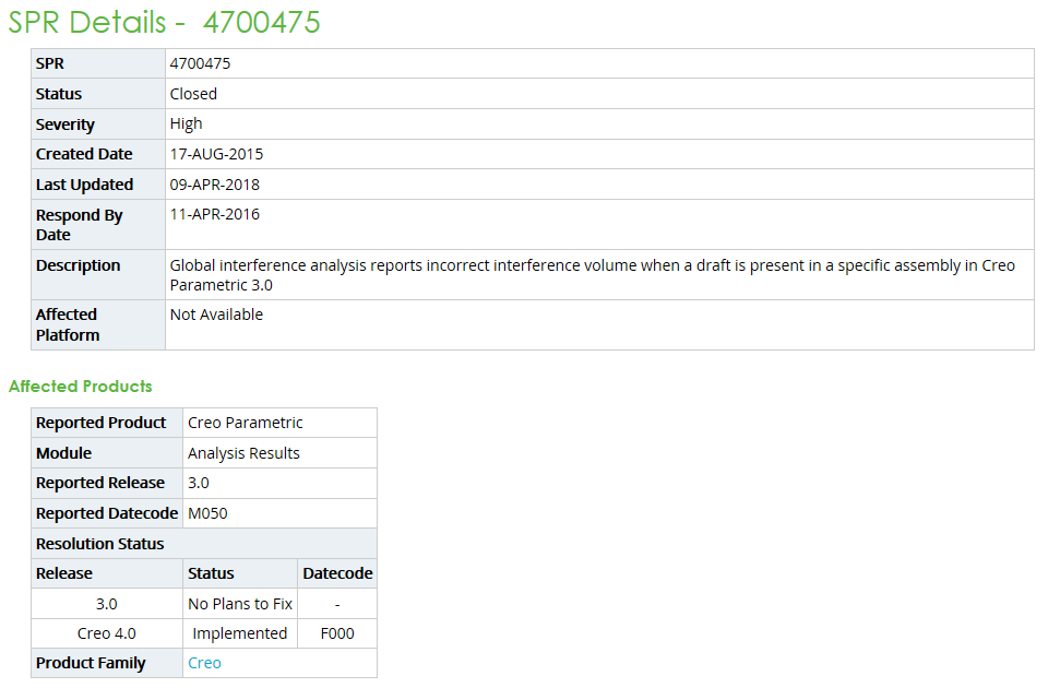

TomU
(To:dgschaefer)
I finally received a response from PTC... after 2 years.  This has been corrected in Creo Parametric 3.0 M140 and 4.0 F000.
https://www.ptc.com/en/support/article?n=CS215787
https://support.ptc.com/appserver/cs/view/spr.jsp?n=4700475
