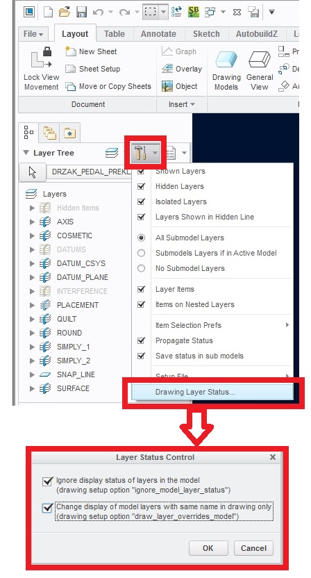

 other usefull function is make drawing layers independet on model layers. You can set it in drawing space. See picture below:
Regards
@mbonka
Or you can set some layers to isolate state. It means ONLY THIS layeras will be visible.
