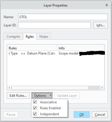

I have a model I'm working on understanding / animating. It has a number of datums added within subassemblies.
In searching for the easiest way to hide all datum planes (which for some reason don't disappear when I turn off plane visibility) I found a method recommended to:
  • Create a Layer
  • Add elements to layer
  • Hide Layer

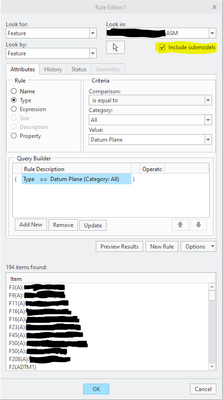

This is looking pretty good, and when I go to add all the datum-planes using a Rule, all the layers I want to hide are "collected." NOTE: Include submodels is selected.
As you can see it shows 194 elements found that match [Type = Datum Plane]

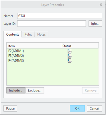

When I hit OK however, only the assembly default 3 remain in the filter.
See the rules and Options for this selection:
When I press "Edit Rules" shown above, the Include Subbodels is no-longer selected...
This seems to correlate with the results that I'm getting.

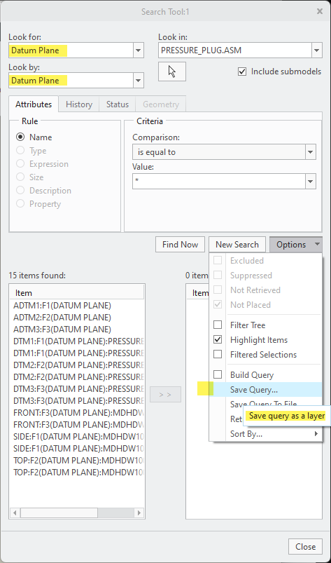

tbraxton
(To:D_Hale)
In the top-level assembly. Use the search tool and select the options shown and report back if all datum planes are assigned to a layer using this technique. This should create a layer containing all datum planes in all of the models including components within the top layer assembly.

D_Hale
(To:tbraxton)
Thanks for this!
Was really confused by how my query would "catch the fish" and then "let them through the net" once I tried to save / finalize it.
This worked and I was able to make a new layer and more efficiently manage the visibility of these planes.

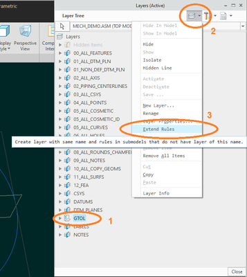

pausob
(To:D_Hale)
The thing is that a layer can only contain items of its model.  So even though the search tool will return datum planes of assembly sub-components, these sub-component datum planes cannot be placed on assembly's layer.  You will have to create the same layers in the sub-components, then act on the layer "grouping".  @tbraxton showed one technique that will create the layer in all sub-components from the search tool..
Another method is if you have a rule-based layer in your top level assembly (named GTOL in your example), and wish the same layer to be in the sub-components, then you can "propagate" this layer to all sub-components with the "Extend rules" function:
D_Hale
(To:pausob)
Excellent! Thanks for the tip I will also give that a shot.
Seems like a convenient way to push rules down once you know they're hitting the right targets in the upper layer.
