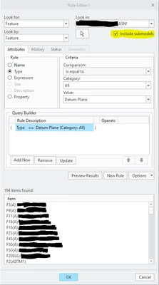

I have a model I'm working on understanding / animating. It has a number of datums added within subassemblies.
In searching for the easiest way to hide all datum planes (which for some reason don't disappear when I turn off plane visibility) I found a method recommended to:
  • Create a Layer
  • Add elements to layer
  • Hide Layer
This is looking pretty good, and when I go to add all the datum-planes using a Rule, all the layers I want to hide are "collected." NOTE: Include submodels is selected.
As you can see it shows 194 elements found that match [Type = Datum Plane]
When I hit OK however, only the assembly default 3 remain in the filter.

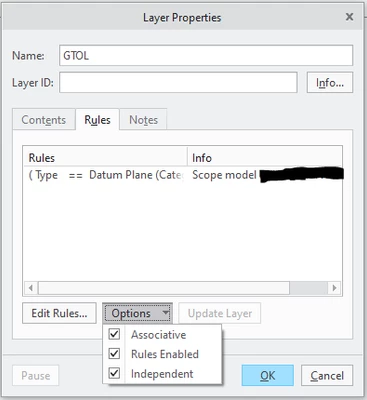

See the rules and Options for this selection:

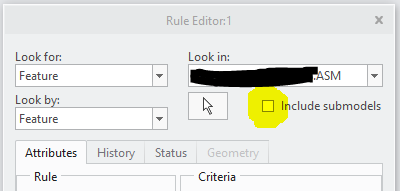

When I press "Edit Rules" shown above, the Include Subbodels is no-longer selected...
This seems to correlate with the results that I'm getting.

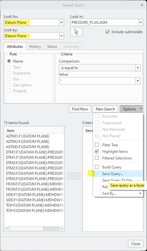

Best answer by tbraxton
In the top-level assembly. Use the search tool and select the options shown and report back if all datum planes are assigned to a layer using this technique. This should create a layer containing all datum planes in all of the models including components within the top layer assembly.

Thanks for this!
Was really confused by how my query would "catch the fish" and then "let them through the net" once I tried to save / finalize it.
This worked and I was able to make a new layer and more efficiently manage the visibility of these planes.

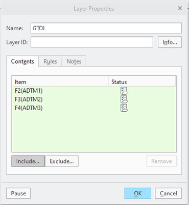

The thing is that a layer can only contain items of its model.  So even though the search tool will return datum planes of assembly sub-components, these sub-component datum planes cannot be placed on assembly's layer.  You will have to create the same layers in the sub-components, then act on the layer "grouping".  @tbraxton showed one technique that will create the layer in all sub-components from the search tool..
Another method is if you have a rule-based layer in your top level assembly (named GTOL in your example), and wish the same layer to be in the sub-components, then you can "propagate" this layer to all sub-components with the "Extend rules" function:

Excellent! Thanks for the tip I will also give that a shot.
Seems like a convenient way to push rules down once you know they're hitting the right targets in the upper layer.
