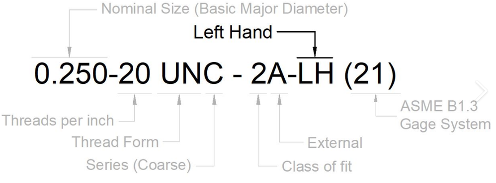

maybe this is trivial, anyway I ask: how to do left-handed threads in PTC Creo Parametric 9.0?

Symbolic representation of RH and LH threads would be the same. In your thread callout, just add LH after the thread type.
If you wanted to automate it a little, create a new hole file for the left-hand threads and modify the automated calout information to indicate LH.

It is typically dealt with in the hole callout/note with the suffix "LH". This is a US standard example; it may be different for ISO/EU standards.

thank you for this hint, for me it is solved.
