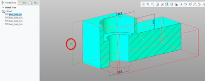

We use Creo 8.0.4.0, and I try to perform the views primarily in 3D as Combination States before I  apply them in 2D drafting,  This problem is somethin I face only for the 3D visualization.
For cross-section view I face the problem that an annotation derived from the feature dimension becomes invisible because I cut-off the attachment point of the dimension. See pictures:
picture 1 with invisible dimension 15:

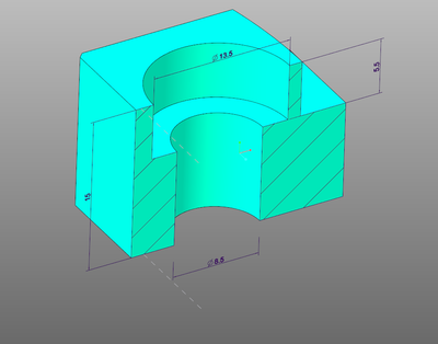

picture 2 with highlighted dimension 15, selected in the Detail Tree:
I the selected dimension is released it becomes invisible again.

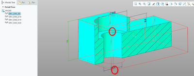

The dimension becomes invisible because the attachment points of the dimension is cut-off by the cross-section. (Experience from several similar situations)
If I switch the section direction the dimension 15 becomes visible.

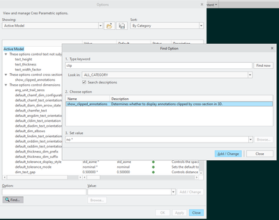

Try setting the detailing option "show_clipped_annotations" to yes.
Pius
(To:pausob)
Perfect !
Works at the first attempt.
Thank's a lot!

Have you tried using the following model detail option: show_clipped_annotations yes ?
Pius
(To:Mfridman)
Yes, I did change the definition of properties, and it works !
