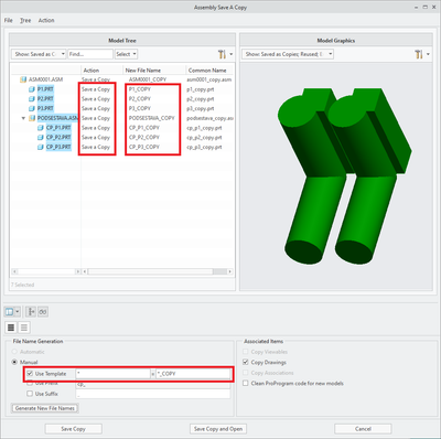

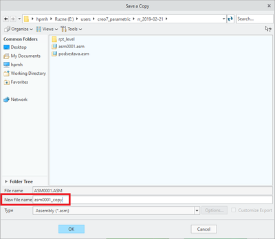

in case that the original assembly is "simple one" (I mean only a set of components assembled together), You have to force Creo to create new components. See pictures.
Model tree of original assembly
Save a Copy dialog box
Assembly Save a Copy dialog box
