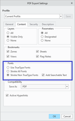

Several config options have been added that allow certain PDF export settings to be pre-configured.  Depending on what else you need to change, these may be enough to avoid needing to mess with .DOP files.
  • intf2d_out_pdf_stroke_text_font
  • pdf_linecap
  • pdf_linejoin
  • pdf_use_pentable  (and the corresponding pen_table_file option)

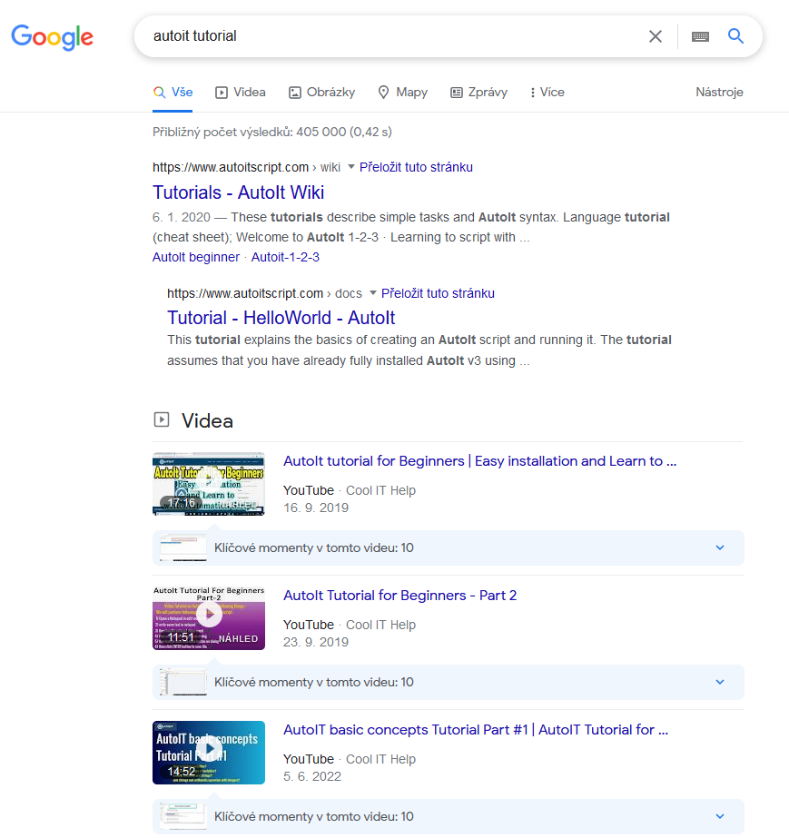

Can someone point me towards some tutorials/post/videos on AutoIt?  (By the way is it Lt or I (eye) t?)
@Dale_Rosema wrote:
Your video looks great.
AutoIt (eye)
not AutoLt
Simply said AutoIt enables you to "automate" almost any action you are doing manually.
Ask Google ... autoit tutorial ... and you will get useful links.
