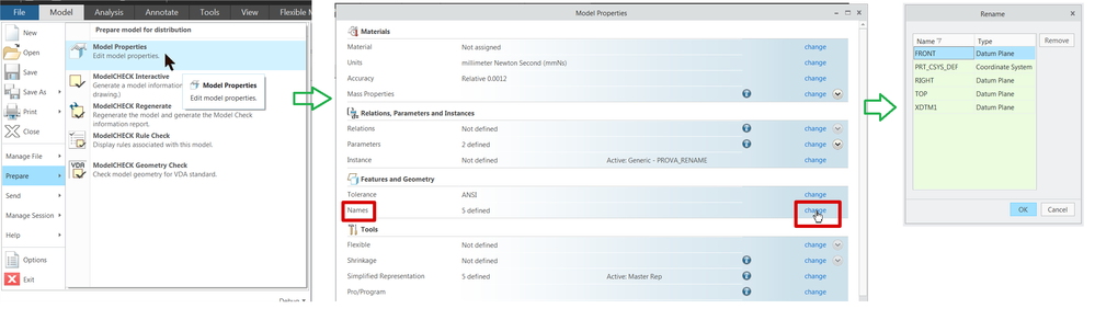

Hi Doneill,
If you don't like to search for planes in the model tree, you could use Rename from Model Properties, save the mapkey using this alternative way...

@Trebla wrote:
Hi Doneill,
Hi @Trebla ,
I tried to create a mapkey using your suggestion ... unfortunatelly with no success.
Martin Hanák
Hi @MartinHanak
Yes, I was wrong, useful mapkey is not possible with Rename...
doneill
(To:Trebla)
Thanks... I never noticed you could change the names there...

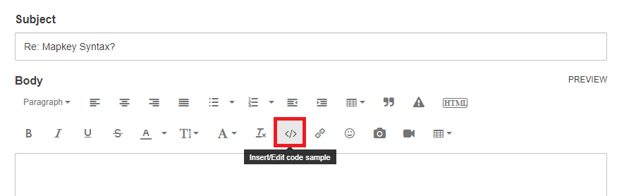

(Martin - I have a question... I like how when you post code, it looks like it's in a text box... how did you do that?)
The Search Tool works fine... (see the code I posted in  Mapkey - Select a Plane without using the Mouse )
I'm just trying to expand my knowledge of Mapkey Code...
Are there instructions somewhere on  Mapkey Commands & Syntax?
I figure there are probably some good tricks out there...
use following button to insert text box.
Note: PTC does not provide any official information concerning mapkey syntax.
