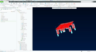

I've got some issue using mechanism. I have this little subsystem that's supposed to go up and down to lift up the tray from the conveyor.

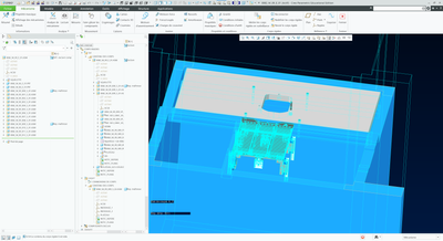

When I work on this subassembly as we can this the movement is correct and 2 body are highlithed. The static body (in light blue on the first screen) is dirrectly link to the main origin of the subassembly. However when I import this in the main assembly making the subassembly origine fixed in the main assembly, in somehow the subassembly became one single rigid body. As we can see on the second screen there is only 1 body highlighted including the tray and the mooving part.
Furthemore when we look at the mechanism tree, on the second screen there is actually a second body but it only includs origins.
