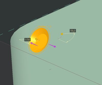

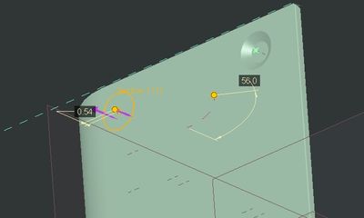

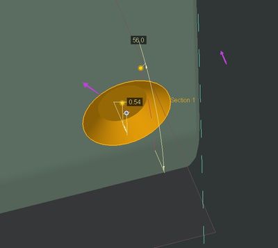

I am working on a model in Creo Parametric 8 Sheetmetal and having difficulty getting a feature to mirror correctly. The model is U-shaped and on one of the legs I have created 2 identical sketch forms. I then mirror the forms about a plane to the other leg. The upper form mirrors correctly, while the lower one does not. The form has an OD of 3.58 inches and when mirrored it comes out at 3.2 inches. I have tried re-drawing the feature and I have tried mirroring about a different plane. No matter what I do, nothing seems to work. Am I missing something here?
This is the original sketch form:
These are the form properties:
This is what happens when I mirror, one correct one wrong: 
When I correct the form to make it work, you can see the OD of the form is inside the OD of the sketch: 
I would like to keep the design I have if possible, it's parametrically driven and if I manually create this form on both sides of the model I will have to have twice as many parameters for placement. I'm trying to eliminate possible sources of errors like values not copying correctly in the spreadsheet. Any ideas? Thanks in advance.

I'll see if I can explain it a little better, I know the screen caps aren't the best. The original forms point towards the middle of the U shape (I'll put a pic below). When I run the mirror command, the upper form mirrors and points in, the lower form points outwards, rather than inwards, if that makes sense. I have to edit the form and flip the direction of material deformation in order to get the correct directional result, though the diameter is wrong. The third picture in the original post are what it looks like when I execute the mirror command. The deformation direction is pointing in the wrong direction.

The forms more in the foreground are the source, the background forms are the result.

I was able to create a part that looks like yours but I wasn't able to reproduce your issue. I did find a way to get the background forms to point the wrong way. To do this, I created the first forms, mirrored them, and then flipped the original. The mirrored form didn't respect the direction change but it was both, not just the lower one. To fix it, I deleted the mirror and recreated it. Maybe this is worth a shot?
I think I'm still a little suspicious of the feature being so close to a bend but it's hard to tell without looking at your part. Can you post it?
Here is my part for reference and its model tree. The bottom surface of my U shape is the first wall feature.
I moved the source form 0.1 inches and that fixed the problem, you are correct that it's too close to the bend. Now my next question is: does a setting exist I can change, like a sensitivity or something, to make that not happen? I know the answer is probably no, but it's worth a shot. If I can't fix the mirror, I'll have to bite the bullet and make two sets of features. Thanks for your help!
