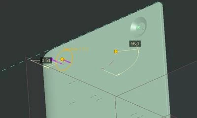

I am working on a model in Creo Parametric 8 Sheetmetal and having difficulty getting a feature to mirror correctly. The model is U-shaped and on one of the legs I have created 2 identical sketch forms. I then mirror the forms about a plane to the other leg. The upper form mirrors correctly, while the lower one does not. The form has an OD of 3.58 inches and when mirrored it comes out at 3.2 inches. I have tried re-drawing the feature and I have tried mirroring about a different plane. No matter what I do, nothing seems to work. Am I missing something here?
This is the original sketch form:

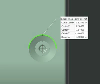

These are the form properties:
This is what happens when I mirror, one correct one wrong:
When I correct the form to make it work, you can see the OD of the form is inside the OD of the sketch:

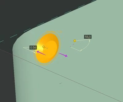

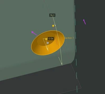

I'll see if I can explain it a little better, I know the screen caps aren't the best. The original forms point towards the middle of the U shape (I'll put a pic below). When I run the mirror command, the upper form mirrors and points in, the lower form points outwards, rather than inwards, if that makes sense. I have to edit the form and flip the direction of material deformation in order to get the correct directional result, though the diameter is wrong. The third picture in the original post are what it looks like when I execute the mirror command. The deformation direction is pointing in the wrong direction.
If I mirror the sketch, will I still have to go in and manually add the form? If I can get the models to work correctly, I will be using these fairly frequently for work and I won't have time to add the form every time a new design comes through.
The forms more in the foreground are the source, the background forms are the result.

Here is my part for reference and its model tree. The bottom surface of my U shape is the first wall feature.
