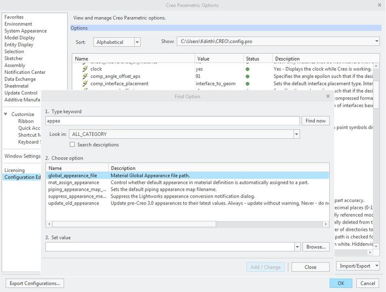

kdirth
(To:ahoerl)
Is this what you are looking for?

Hi Martin,
Thanks for the quick answer!
The PRO_TEXTURE_LIBRARY worked fine!
I had some troubles with setting up the library Directory, because the Folders kept appearing empty.
I found out, that the path you choose for your pro_texture_library has to be the Folder containing the libraryfolder.
For Example the "Common Files" Folder in Creo Installation-Path. This one has be set in the config Option.
the subfolder "graphic-library" contains the structure provided in your link. Then it works.
I already did Setup the File on Network and it seems to work as intended!
