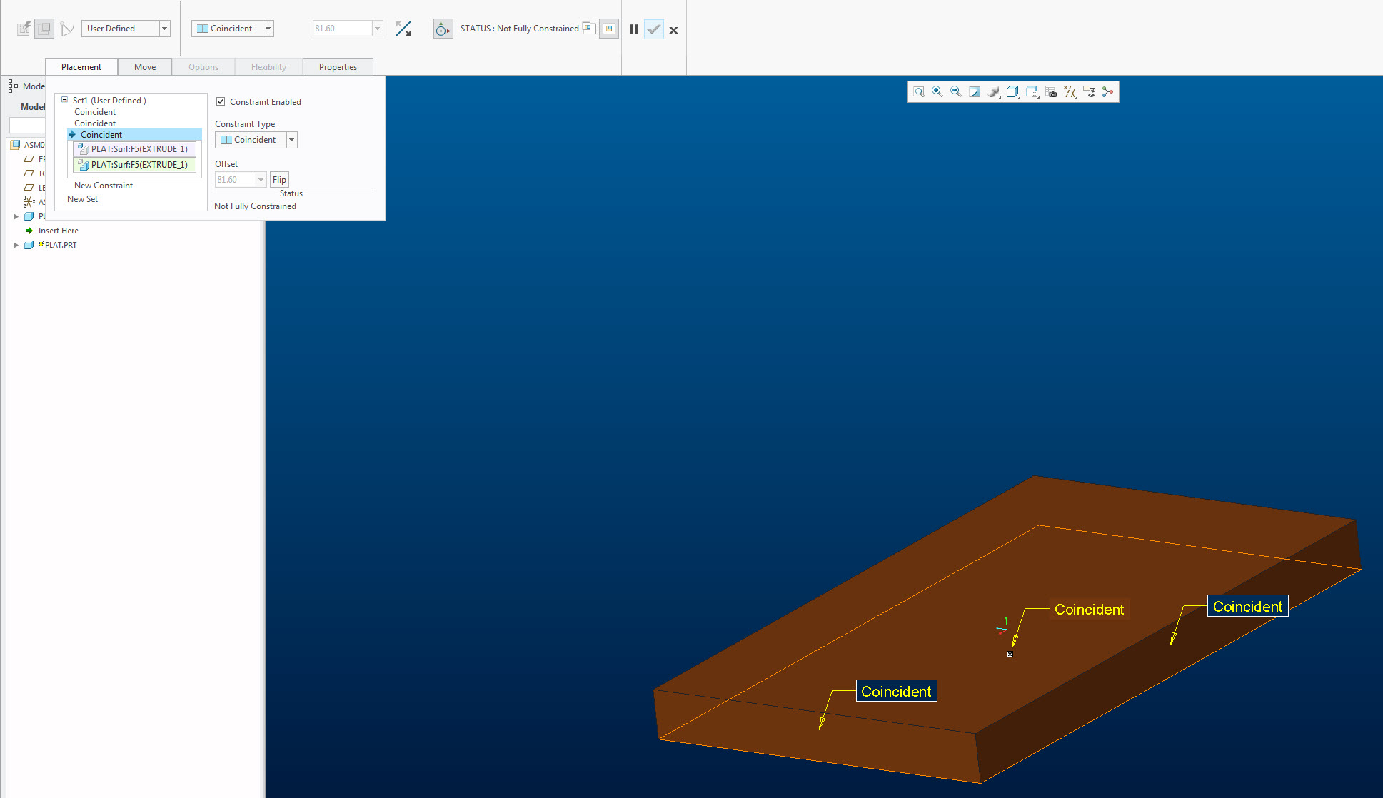

When I try to change a Distance reference in the Placement tab, the constraint type changes from Distance to Coincident. It's like Creo treats Coincident as default and sets all new or edited constraints as "THIS SHOULD USE THE DEFAULT VALUE". Is there a way to get Creo to keep the constrain type, after a reference change, when it's previously been set?

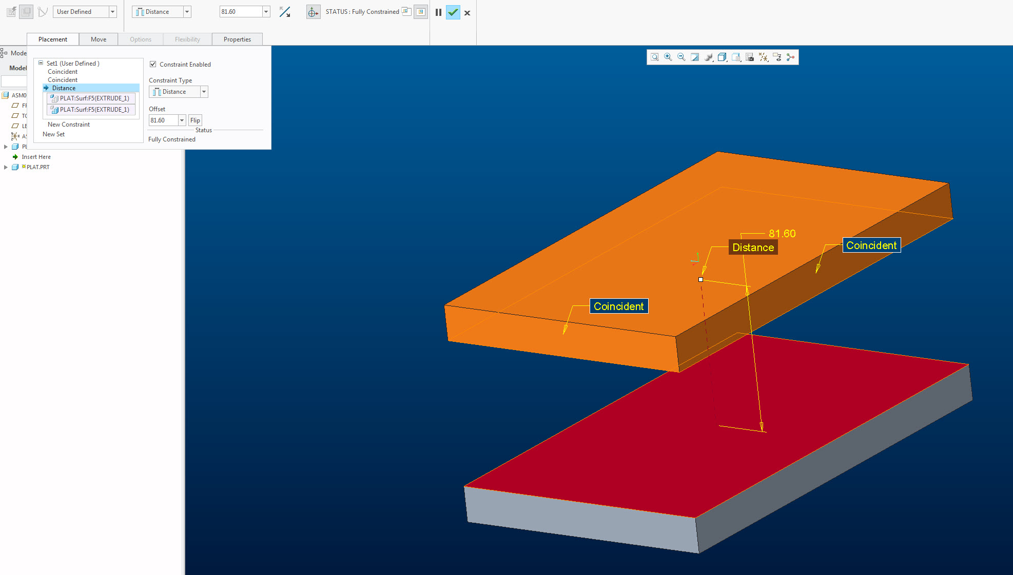

To clarify: I've got two parts where the bottom of the top part has been constrained to have a distance to the top of the bottom part with a offset value. Let's say I want to change the reference on the bottom part and have the distance to the bottom surface instead of the top. If I make this change via Edit definitionPlacement tab Creo changes the constraint type to Coincident (but musteriousluy keeps the value offset value greyed out in the box). Why?
Before reference change
After reference change

It's a config.pro option. You probably have auto_constr_always_use_offset set to never. That's why it changes it to coincident. If you set it to No it should work OK.

Oh, that seems to work! We had auto_constr_always_use_offset set to never, so I tried changing it to "no" and now Creo doesn't automatically change the constraint to Coincide. Does this affect anything else (might be a broad question) which means I need to think twice before changing this config value?
