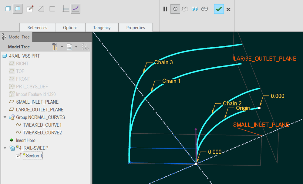

You can do a 4-curve VSS where you define curves to drive all 4-corners of the cross-section:
4-rail sweep
sweep cross-section
sweep trajectories
those curves can be tweaked (tugged around like you mention) using the "Tweak Curve" tool inside the edit-definition tool:
Curve tweaks
This is basically poor-man's ISDX - so if you have that license, that seems like the best tool for the job.
