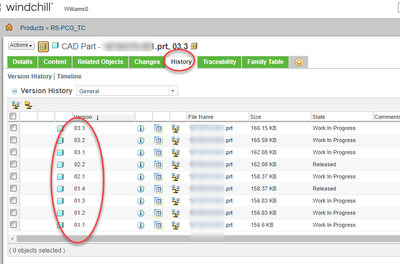

StephenW
(To:KA_10463142)
Look at the history of the part in the commonspace to see what the History of the check-in and revision history is
Every time you check in a model the revision goes up one point (e.g -.1, -.2, -.3)
If you Revise the model in windchill the revision goes up one level (e.g. -.0, 1.0, 2.0 or A.0, B.0, C.0).
