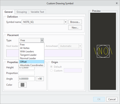

Community,
I have created some notes on a drawing, and I am trying to figure out how to make symbols float with the notes.  Unlike the previous post where I asked how to make a leader note with a balloon note, this is a little different.  For example, I can make a flag symbol with a note number inside the flag, but if I move the note, the flag symbol will not move with it.  Unlike making a balloon note where I can choose offset, I could not find this feature with symbols, even under the attributes for symbols.  Is there a way to do this?  Thanks in advance.
StephenW
(To:ThoRig)
You have 2 options, if you symbol has the "offset" option, you will pick the note you want it to attach to and then place the symbol
-OR-
if you don't have the offset option, you can use the RELATE TO OBJECT command in the annotate tab after you've free located the symbol.

ThoRig
(To:StephenW)
The flag symbol just happen to have offset under the placement type, and that worked.  Thanks.
