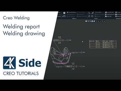

Hi All,
Can I see that how many weld feature I used?
Can I see this as a parameter on Creo?
Thanks for replies.
Check following video by Vladimir Palffy
https://youtu.be/0wRUtUTiqsQ
Let me know, If it helps you.

Thanks for this video suggestion. It gave me clue about it. İt became so useful for me.
Actually my aim was doing weld cost calculation. And absolutely it ll help me.
Thanks again.
If you define WELD MATERIAL & WELD PROCESS it will be added advantage for you to do WELD TIME & COST Calculations.
https://www.youtube.com/watch?v=0YN38XdFCpE
https://www.youtube.com/@4kside/search?query=Weld
