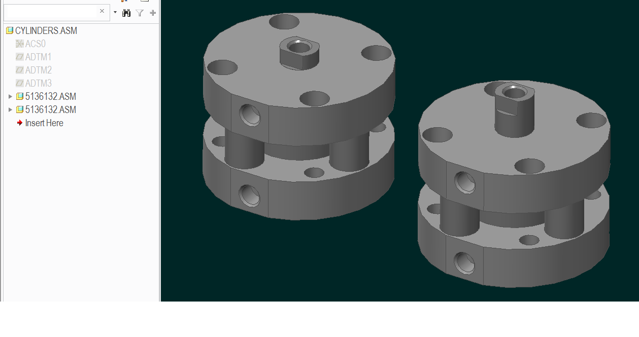

Hello.
I have a subassembly (a pneumatic cylinder) which is used several times in a main assembly. The cylinder piston is constrained with a mecanism constraint (cylinder) so that it moves in and out. When I drag one piston all pistons from that subassembly moves, I would like to be able to move each piston individualy. Is that possible?
//Linus
You will need to make the subassembly flexible so that the each can act according their own constraints.
Highlight the sub-assembly in the model tree, RMB and "Make flexible".  At that pont, you should be able to select a parameter that allows the sub-assembly to vary.  Be sure that it is not over-constrained.
Try flexibility in a smaller test assembly if you have trouble.

Thanks Tom I will try that.
I probably should have added a few caveats.  I am assuming you have the piston locked in some library version that is locked to some known dimension.  Locking regeneration values in mechanism assemblies have stopped things from moving for me at higher level assemblies.
So the safe way is to make the mechanism element in the sub-assembly flexible and manage it in the higher level assembly.  It all depend on the level of geometry control you are required to incorporate.
However, making a component flexible is not necessary in all cases.  Evaluating a system that is locked up is AGONY!  So much so that I simply start over if the project can manage it.
I've attached a file, commercial core Creo 2.0, that you can lift (drag component) the upper knob and the two identical cylinders will work correctly in real time.
Enjoy.
(tip: turn on the placement folder in the assembly tree.)
(tip: slider and pistons are similar. If you don't need rotation, sliders are simpler.)
(tip: you can use multiple mechanism constraints on the same sub-assembly - ref: cylinder pivots.)

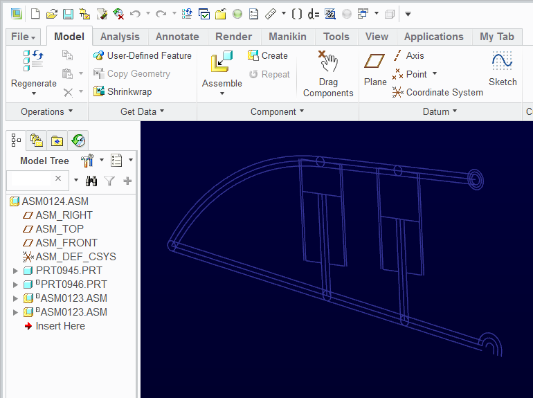

pausob
(To:Linusskf)
I've modeled assemblies that involve multiple cylinders working in tandem, and also assemblies which have multiple cylinders working independently to create complicated end effector motions.  The two situations are not the same and to prevent lock-ups, I caution that you really have to be aware of the maths that are happening under the hood, and the pitfalls of over-constraining the system.  Creo will often allow you to put two "actuating" cylinders (that is, subassemblies that involve a cylindrical joint with specified regeneratoin value for the position of the piston) in between a common base and end effector and you think everything is hunky-dory.  But next time you open your design, you find one of the cylinders is flipped, or you get the "mechanism cannot be solved" message.
In these "tandem" situations, Creo needs one of the cylinders to be the "actuator" and another to be the "follower".  It is possible to build all this into a single cylinder model by utilising the PTC_CONSTRAINT_SET parameters and flexibility functionality, but this is not for the faint at heart.
Note: if you don't have the "enable regeneration value" ticked off, then you should be able to place the cylinders in the parent assembly and move their pistons independently:
