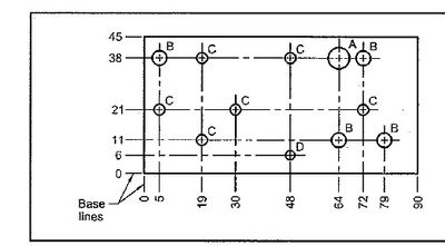

Ordinate Dimension Orientation:
I want to flip my Dimension text around 180 Degrees.
My Parts 0 is at the left of my drawing and is the bottom of my part. And what is at the right would be the top.
So I want the bottom of my text facing the other way.
Any Ideas. I don't have room to flip my text horizontal.

Unfortunately ASME Y14.5 (1.7.5.3) specifically states that baseline dimensioning should be read from the bottom or the right side of the drawing. I don't think Creo allows flipping the direction due to that limitation.
(the standard states "should" and not "shall" so your drawing would not technically be wrong if you could figure out how to get the text to show in the other orientation

What I was really getting at was that since the standard states from the bottom or the right, it's typical that Creo will NOT allow it to be from the other orientations. They like "shall" with no exceptions instead of "should".
