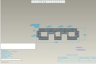

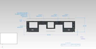

 I'm exporting Sheetmetal parts to CreoViewer (.pvz file) with a combination state set as the flat pattern, but the export combination state does not reflect the Creo displayed model.
CREOVIEWER FLAT DISPLAY STATE:
Creo Parametric Flat Display State:
If Someone could point me in the correct direction to get these creo PVZ file to export with the same info as creo parametric that would be ideal.
