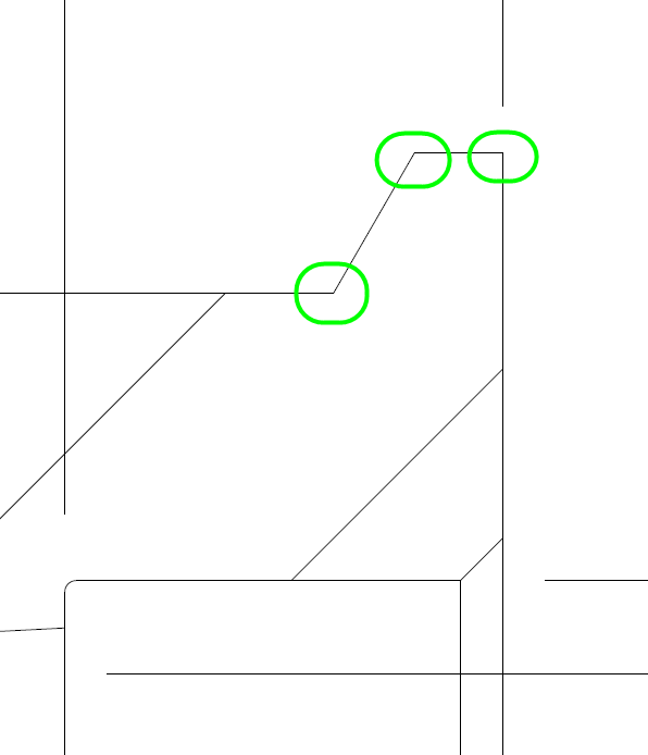

Has anyone else seem these issues with PDF files being created from CREO?
There are many different paths that all lead to the same result for me but in this case I used FILE, SAVE AS, EXPORT, PDF.
The first image show the default result show in Acrobat using the PDF EXPORT SETTINGS of 600 dpi, no pen table,linecap=butt, linejoin=miter.
Zooming in, note the poor line quality.

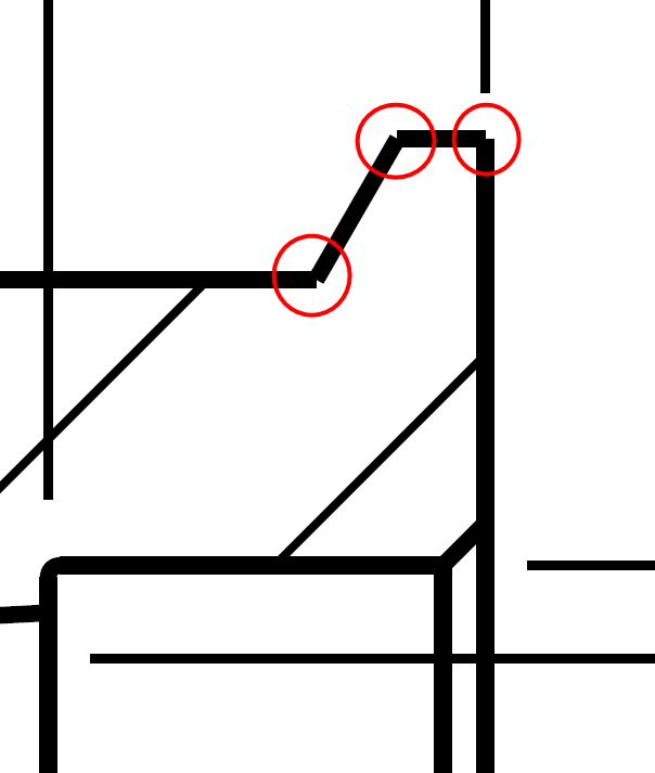

The second image is from the same file but with line weight turned off in Acrobat (ctrl+5).  This is the image I prefer but there seems to be no option to make this setting stick in the file or Acrobat.  Worst of all, printing always comes out as shown in image #1.

Your lines would look nicer if you used rounded line joins and line caps.
The reason they look better with line thickness turned off is when the thickness is turned off Acrobat sets the line to 1 pixel thickness regardless of zoom. You can make a similar effect by making the lines very thin and to do that you need to either create a pen table with small values or use pen#_weight (I forget the exact config option) that is used when the pen table isn't. When the thickness is less than 1 pixel on the screen, Acrobat will substitute 1 pixel width.

it looks like the problem is related to the border of x-section. Lines related to the hole are displayed correctly. If I am right then you can report the problem to PTC Support as a bug.
MH
Martin Hanák
The interior lines for the hole on the PDF mutually overlap closing the gaps.The lines end just as poorly, but that result is masked.
For pdf export I'd try pdf_linecap=round. See attached pdf file for the result.
