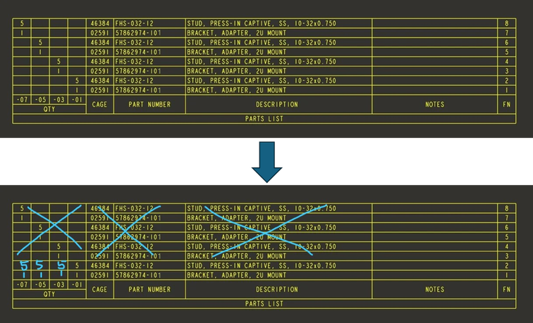

First of all, since it is a machine translation, the text may be strange.
I would like to modify the bom as shown in the picture below.
I tried to find as similar cases as possible, but I think my skills are lacking.
I would like to change it like the attached picture.
Is that possible? and how?
Thank you for helping me, despite my shortcomings.
(creo 9.0.4)

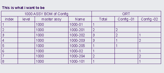

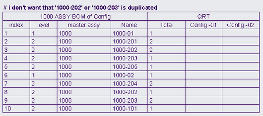

JJays
(To:kdirth)
Although it is different from the photo in the question,
I have attached a file describing the problem I am experiencing and the direction I want to be.
PLZ i really need it.
Thanks for your help.
MartinHanak
(To:JJays)
I would say that's not possible.
