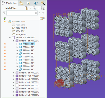

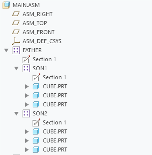

Im just doing test for my thesis. All i wanted is being able to create an assembly using patterns and parts.
In this case, I had created a part and then I built a pattern (son 1). Once that pattern had been created, I built another pattern of that pattern (Father) which includes both patterns.
My final purpose is to create another pattern which multiples Father a few times.
How can I create a geometry pattern of a pattern of a pattern?

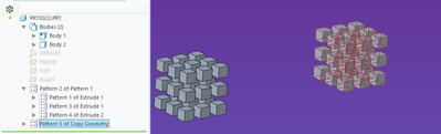

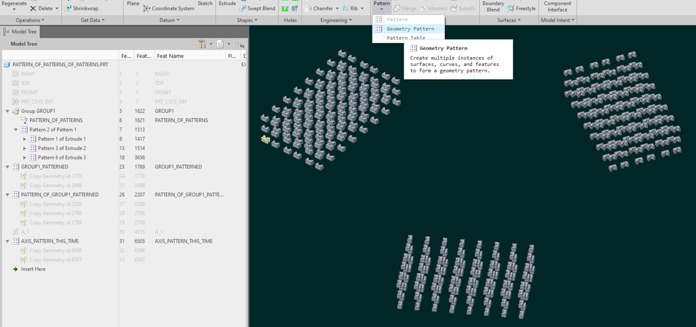

Note that geometry pattern can be applied numerous times to duplicate geometry generated by previously applied patterns:

How did u create that? I dont know how to insert "Pattern_of_patterns" feauture to create a group with the pattern. I dont know how to create that pattern that includes copy geometry neither.
