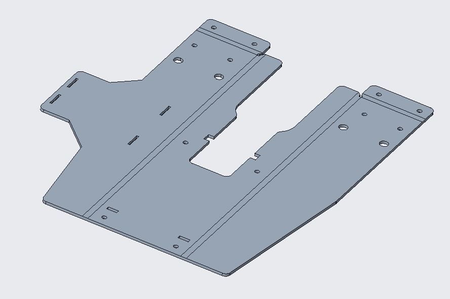

Attempting to measure total distance to laser cut this piece of sheetmetal.   Followed directions in another post here about unbending and then creating a cross section thru the thickness and then a datum curve thru that section.  Upon creation of the datum curve it wants to bend back the form so I can't get the curve to go thru the flat.  It's too tedious to measure each length of entity to burn picking them individually.
I can't be the first one to have this issue.  I'm in Creo 4 if it matters.

When you make the flat, use the unbend command, not the flat pattern command.

Ok, I see why this method didn't work earlier.  There was already a flat pattern feature in the tree that was suppressed.  When I tried to do anything in the flat it suppressed this again.  Deleting the feature and following your steps worked as I expected.
