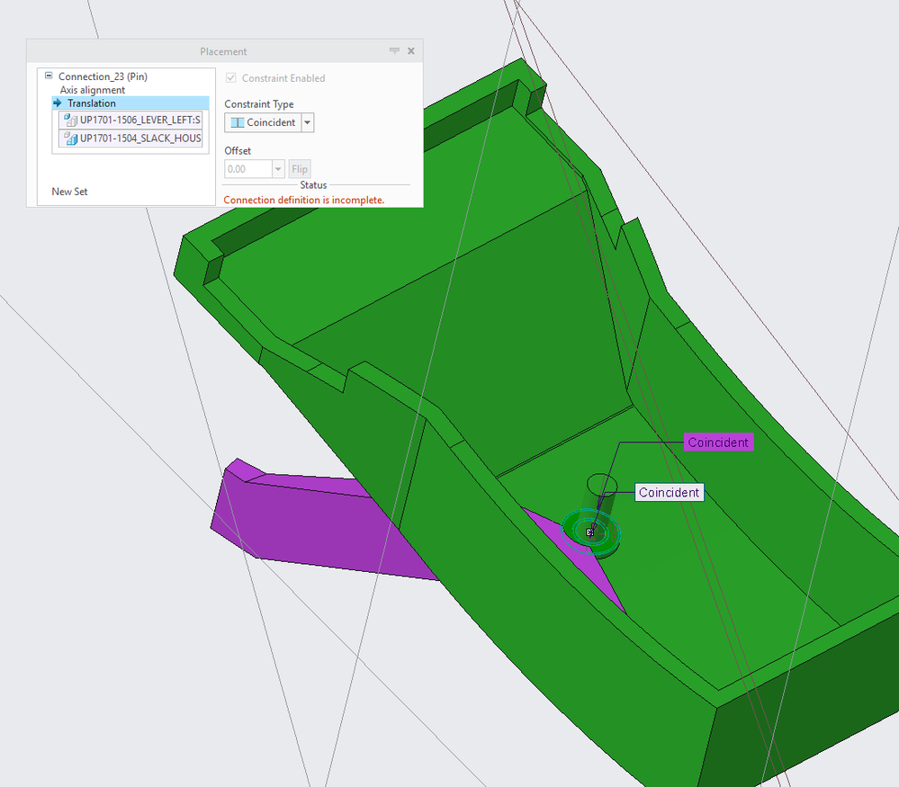

I am trying to connect two cylindrical shapes with a pin connection so one rotates around the other. I added the Axis alignment and the translation surfaces but Creo still says the connecition is incomplete. I am also not able the flip the connection. Can anyone tell me what is going on and how to fix this?

Probably, because you leave 1 degree of mobility - which in itself is not a fixed object. If you exclude rotation around the axis - the part will be completely corrected.

The red part is constraint with a "Default" so it is completly fixed. Here I used the pin connection but I also tried a coincident on two axis and a coincident with two perpindicular (to those axis) surfaces, which didn't work either.
I added the files, in case someone has time to check them.

Recreating the assembly fixed the problem. Still don't know why it didn't work before but now it does.

maybe pin references are not correct.
Suggestion: Create test assembly containing two simple cylindrical parts and test pin connection creation.

I'm posting  a message on this solved question because I get the same error on creo 7. My Pin connection is said to be incomplete but it isn't. I followed the  previos steps and still can't make my assembly working. Also, I have this message for all types of connections.

My guess is you used datum features from another part to define the connection type. For example in a pin connection, you might have aligned the axis correctly but for the translation you probably picked the front plane from the main assembly (or another part) instead of the front plane of the specific part you are connecting to. So in this case the error kina makes sense since it only wants dependencies on the part you are connecting to. This was my issue at least.
Hope this helps.
