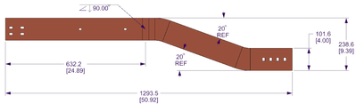

I am trying to create planer bend in Sheetmetal part in Creo.
In  Planer Bend Thickness is different than real thickness, how to use Bendtable feature to apply Bend allowance ?
I tried with basic bend table to planer bend feature , Flat length is not changing.
Anyone knows how to use this Planer bend feature and get correct flat length.

Do you have an example screenshot of what you are needing or can you share and example model?
In general, creo does a great job on sheetmetal parts bending and flat patterns for operations similar to press brake operations in a sheet metal shop, Bending sheet metal parts thru the thickness of the parts
Looking for such bend solution, When we do Flatten, Creo doesn't understand those Planer bends. and we need to apply k factor for those bends also.
