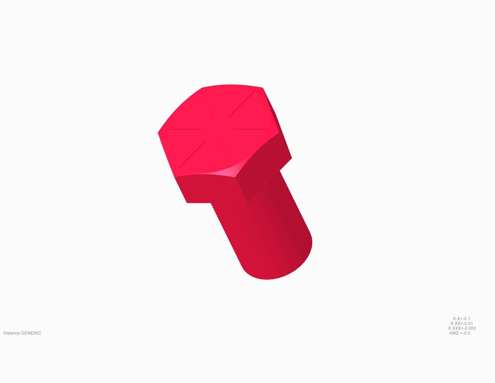

Hello everyone,
today i discovered a little problem. When i tried to save a part to JPEG file, it apeared that it has purple gradient in the picture even though i have my background set to pure white color. I have also discovered that it only appear when i set my resolution to anything higher that 100 DPI, everything higher what 100 DPI will include the gradient colors in the picture.
Thanks in advance.

What version and build of Creo?
I did a 600dpi jpeg with white background in Creo4 M080 and it came out fine.

Are you using some sort of render? The purple looks like the top of a "room wall" since it cuts off below the part and there is a "room" that has a purplish hue
No im not rendering, as i said i go - save as a copy - JPEG - and it does this. Honestly i dont know, u might have a point in the "room" thing. Im using university start tools so i dont know what my teachers putted into the start tools. Is there a way to turn that "room wall" off ?

Make sure your display style is set to shading or shade with edges and not shade with reflections or shade with render.
Usually it's pretty obovious a room is turned on, like in my image but maybe it's zoomed in.
Its not the shading ... i have shading with edges always on.
Do you think it is a syscol kind of thing or the problem is somewhere else ?

I don't think it's a systems color thing but you can go to file - options - systems colors and set your systems colors: to black on white. That will rule that out.
Nope .. didnt change anything ... still have the gradient 😞

That option is used for testing your graphics card compatibility with Creo. If it solves the problem, it typically means the problem is in your graphics card. The real answer can simply be that you need to update your graphics card drivers or it can mean that your card is not suited for use with Creo.
If you haven't noticed any other issues and you only needed to generate that image, you may want to remove that option from your config. You can try upgrading your graphics card drivers once removing the option also.
If it doesn't cause other issues, you can keep the option but it may slow your graphics response or effect creo performance in other ways.

problem resolution = installing "right" version of graphic drivers. See following examples:
https://support.ptc.com/appserver/cs/view/solution.jsp?source=Sitecore Article Viewer&art_lang=en&n=CS324641
related to Creo 4.0 M120
PTC suggestion = install version 451.48 (Nvidia drivers)
https://support.ptc.com/appserver/cs/view/solution.jsp?source=Sitecore Article Viewer&art_lang=en&n=CS320103
related to Creo 4.0 M060
problem reported for version 441.28 (Nvidia drivers)
PTC suggestion = install version 442.23 (Nvidia drivers)

Apparently this Nvidia driver build 451.48 solves this problem (and also another problem that I solved  about a month ago using this build https://community.ptc.com/t5/Simulation/Creo-simulation-problem-with-colors/m-p/675597#M8276)....
