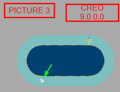

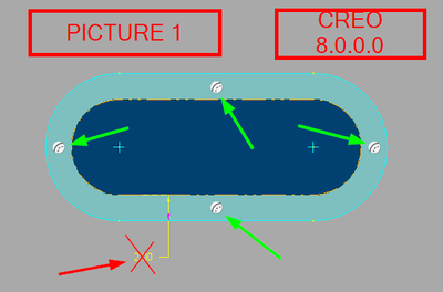

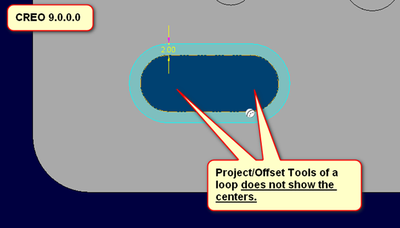

PROBLEM 1:
In creo 9.0.0.0 the project / offset tool does not generate the arc centers of a loop.
PROBLEM 2:
After using the command I would like to be able to select specific segments and arcs generated with the Project / Offset command and then perhaps mirror them, but with the new command it is no longer possible ... all entities are selected as a group, is there a way to explode them?

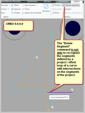

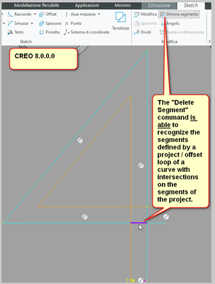

PROBLEM 3:
The "Delete Segment" command is NOT ABLE to recognize the segments defined by a project / offset loop of a curve with intersections on the segments and references.
P.S. Notice the yellow dots that delimit the recognized segments.

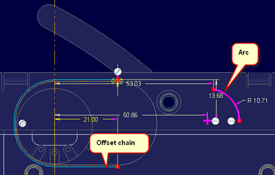

PROBLEM 4:
I would like my arc to have the same radius value as the arc of the offset chain, but the program does not allow me to set the constraint because it sees the entities of the offset chain as "a single group entity".

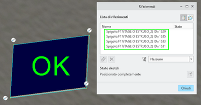

Reverting to the "old" command  is not supported in Creo 9.
The documentation indicates the ability to switch between chain selection to one-by-one.
"Switching from rule-based definition to individually selected items is supported for “Project”-tool"
Have you tested the method presented here?
https://www.ptc.com/en/support/article/CS369555

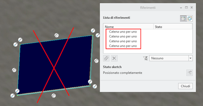

What they propose in the CS369555 to convert the chain to one-by-one for the "Project" tool may be reasonable, but I still don't like it.
What they propose in the CS369607 to convert the chain to one-by-one for the "Project / offset" tool with the "thickness" tool is unreasonable because, in my experience, the tool inevitably creates a double entity profile forcing the operator to select one by one all the entities of the second useless profile.

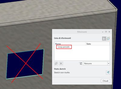

If in the sheet metal environment I try to close an opening with the "Wall" command, and then use the project to detect the profile, the feature goes into error ...
If I draw the outline without using the projection, it works!

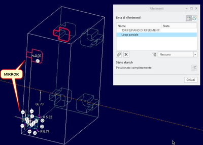

if in a sketch, I mirror a geometry generated with the loop project, the program is not able to maintain the dimensional constraints of the parent geometry ...
Thanks - will check with R&D

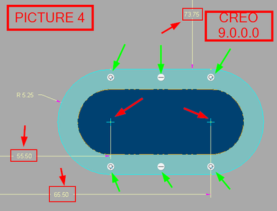

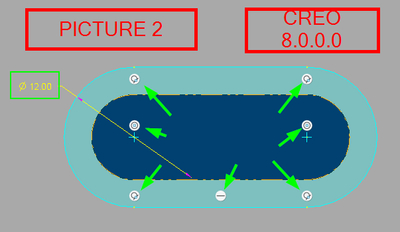

PROBLEM 7:
Usually with Creo 8.0 to create a counterbore slot for screw, I used the project offset command, then I deleted the relative offset dimension (Picture 1),
the program converted the "edge offset" constraints into coincidence constraints, tangency and horizontality and finally I added a dimension to the diameter of an arc of the slot, work completed (Picture 2).
Now in Creo 9.0.0.0 I am no longer able to perform these steps.
When I delete the offset value, the program converts the only offset constraint of the complete or partial loop (picture 3)
into tangent and horizontal constraints but not coincident in the centers of the arcs ... (Picture 4).
This behavior is partly attributable to other unwanted behaviors that I have already reported in other points of this discussion, but I wanted to report it anyway because, for me it is a basic use of the project offset command.

please replay video diameter_dim.mp4 related to PROBLEM 7.
Martin Hanák
bmancini
(To:MartinHanak)
Hi Martin,
thanks for the video, having preached the diameters of the buttonhole is a procedure, which although more elaborate than it was in Creo 8.0, that works! Good job!
I'm curious, have you experienced it personally or have you found it in some other discussion, I tried to look for other discussions but without success.
I just tested if problem 7 is related to sketch reference selection. And I was lucky to hit it.
