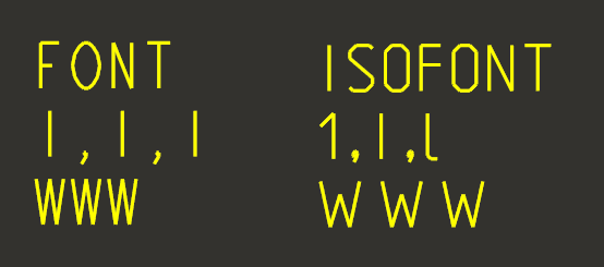

We currently use FONT on our drawings and we have an issue with the 1, I(i) and lowercase L being visually in indistinguishable. So we are looking to use ISOFONT instead, however this has an issue with the spacing of some letters.
So I would like to edit the ISOFONT to reduce the spacing between certain characters, I have gotten as far as:
