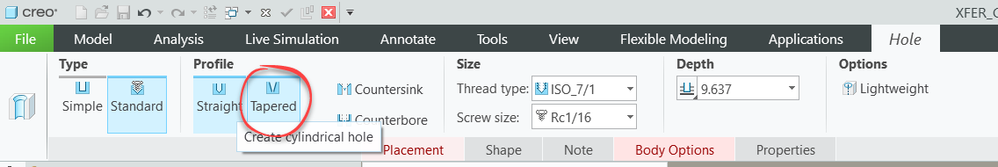

Is the thread you need a British Standard Pipe Thread? Creo does not come with a .hol file for BSPP threads. There is a .hol file for NPT and ISO7/1 threads so you can use that file and create the BSPP threads you need if you want to have standard holes available when modeling. Creo may have the tapered thread you need already in the hole feature. Rc 1/8 female thread is probably what you need, and it is available as a tapered hole feature.
ISO 7-1 is BSPT (R/Rp) – British Standard Tapered Pipe where
  • R - tapered male with external threads
  • Rp - cylindrical female with internal threads
  • Rc  - tapered female with internal threads
The tapered holes can be used by selecting the tapered hole icon in the hole feature UI.
