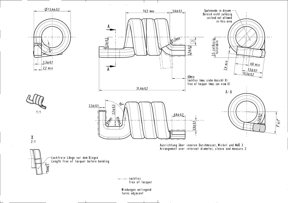

Hello out there,
is there anybody out there who knows how to create a rectangular helical sweep Feature, as in the shown black and white Picture?
I tried my best to get a solution, but it is not to be used. The gradient is somehow not constant in the red area to the blue area. The reason is the great difference between the inner radius and the outer radius. If the shape of the required rectangle increases, or edge lengths are the same length (quadrangle). Then the slope becomes more linear.
Rectangular helical sweep feature_I.jpgRectangular helical sweep feature_II.jpg
Is there any help out there?
Thanks Heiko

I have the wrapped curves projected through "normal to surface"  onto the tapered surface  and results are pretty satisfactory.
I am getting obsessed  to this a little . I found a way to allow me to sweep along a closed contour in Creo and this allows me to create the helical spring with constant gradient. Just want to share it and please ignore if you are already aware of this trick:

mhofert
(To:hhagedorn)
Here is a solution using just three features.
It works also as conical version.
It was created with Creo 3.0. If you can`t open it I also can provide Creo 2.0.

Here is a short description and some screenshots.
1. Datum point (offset coordinate system)
2. Curve through pionts
   - straight line
   - add fillet radius
3. Sweep
    - Selection plane control >> Normal to Projection ( Direction reference in this case "bottom side" )
