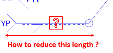

Please check the image and suggest me with the solution like how can i reduce the length of the weld symbol leader.

This has been discussed many times and is the subject of several Ideas.
The default weld symbol cannot be changed. You can make a custom weld symbol, though the interface is not the most user friendly.
