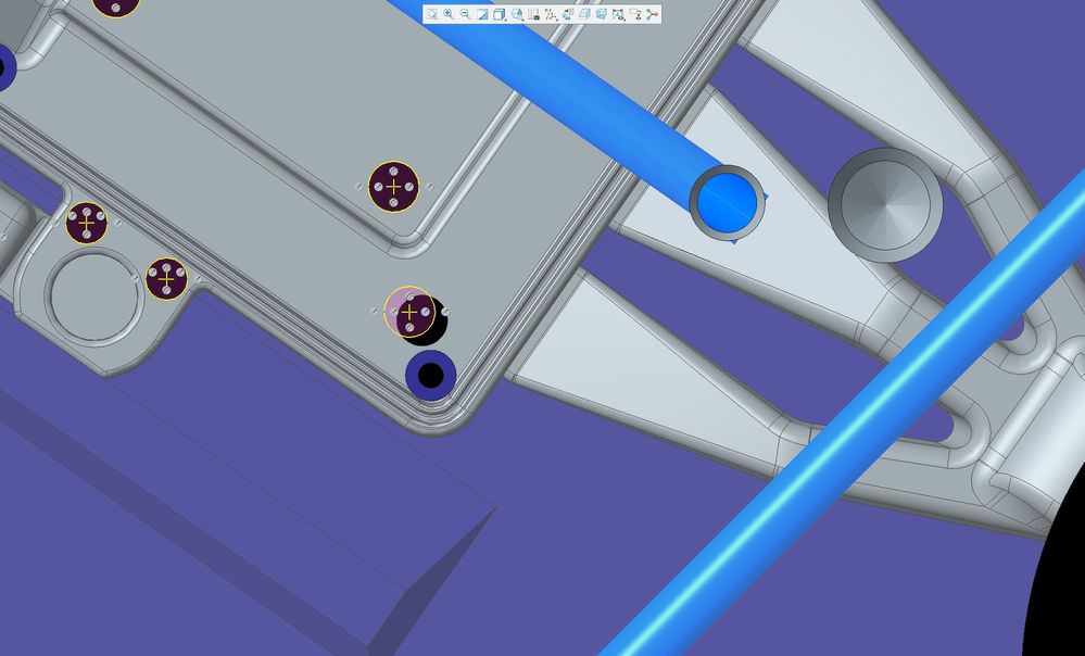

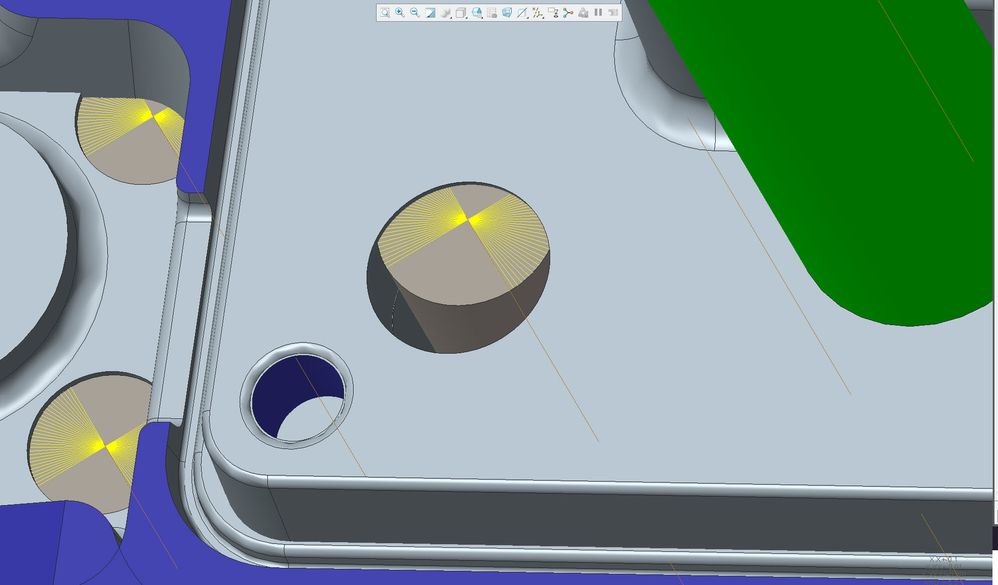

When I  update a feature that a copy geometry references I will change the model but the copy geometry or reference will not follow. In the latest instance I updated a hole.   There is a sketch that references  that hole and in the large assembly a part is assembled to that hole. The hole location moves accordingly but the sketch and part stay in the old position.  This happens randomly.  Sometimes opening a new session fixes the issues. Other times it does not.  Otherwise I have to go into the following feature.  Delete the reference, reselect the reference and then reconstrain.  Creo 8.0.11.0sketch.jpgpart.jpg

I almost always use axis or points. In this instance I needed the sketch to determine the size of the particular holes.(multiple sets of holes from multiple copy geoms in the plate and the corresponding clearance diameter) Doesn't seem to matter though, it will update regularly and then all of a sudden it just decides it doesn't want to anymore.

Yes, I actually have to go into the sketch, delete the reference and re-constrain it.  Even then it reverts back to the "old" reference.  And yes its a pain.  I deal with complex assemblies. More than once I have been burned when its been caught when they are deep into the manufacturing phase.
