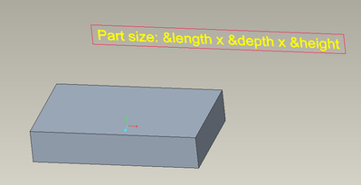

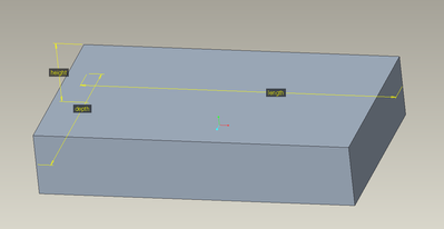

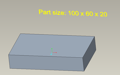

One method is to name the dimensions you want to use in a relation. In this example I have named the driving dimensions of the box to height, depth, and length. You can then use those names as parameters in notes or relations. Creo 7 model enclosed for reference.
See this article for details on protocol:
https://www.ptc.com/en/support/article/CS313862

My suggested approach is based on an assumption about how you wanted to use the values. What exactly do you need to use the parameter local_description for? Is it used in a note or in a table cell on a drawing, or something else? Why is it important to have local desc to have a string dependent on model dimensions?
The method I shared is fully parametric, is very robust and does not require any relations. You can of course use the dimension names in relations. I used them to create a model note whose values are driven by the dimensions.
I only named the dimensions using a word to clarify how to do it. There is no need to rename the dimensions to use them.
Using this syntax (below) you have a parametric note driven by the dimension values. You can concatenate dim values to form a note with multiple dims without using ITOS function.
Part size: &length x &depth x &height

You can just use the syntax presented in a note in the part or on the drawing. If you turn on annotation display in the model I posted you should see the model note as shown in the screen shots with the dimensions.
If you edit that note you will see the syntax using the dimension values.
Based on your use case I would create a note and use the dimension values in the note. This will be fully parametric and will update with changes to the model.
