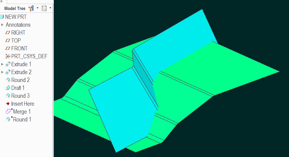

You can get a similar result in a different way.  Surfaces to be "filleted":

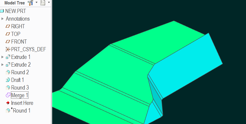

by first merging your surfaces:

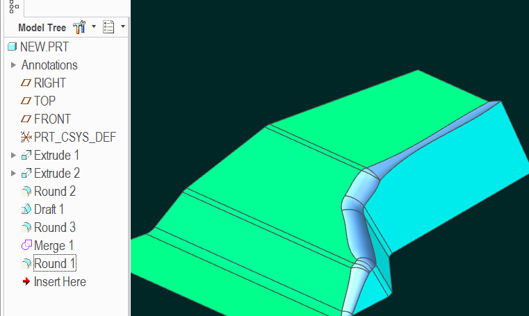

thus creating the sharp edge, which you can then round over:

You can merge the surfaces telling the system which side of the surface to keep, which replaces the need to intersect and trim. Once the surfaces are merged then round the edges. For the final round you need to add radius values.
