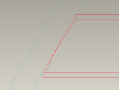

Hi All,
I'm using Creo 8.0.
Hopefully somebody here can help me out since I haven't been able to find a solution on the internet yet.
Quite often I have to design tubes which will be cut from sheetmetal and then rolled into their round shape. Therfor all cuts need to be normal to the sheetmetal plate. So far so good. However when I need to make a simple angular cut at the end of the tube things get frustrating pretty soon.
When you look at attached cross section you will see the upper end is exceeding the cutting line. Here I've used normal to driving surface. When I use normal to offset surface the upper end is fine but the lower end is exceeding. I do understand what it is doing so this still makes sense to me. Therefor I would expect "normal to both surfaces" should do the trick but this feature doesn't work at all.
This is frustrating cause a simple cut like this can't be done in one feature but always requires more features.
Am I missing something here or is it just a bug?

Please read the question. In your example you're not cutting normal to the surface. I need to cut normal, however I need to avoid this exceeding volumes at either the upper side of the lower side.
kdirth
(To:BartL)
I believe you are looking for this:
The circled setting is the key to preventing exceeding the cut line.
BartL
6-Contributor
(To:kdirth)
I know this function. I wrote the following in my first post: "Therefor I would expect "normal to both surfaces" should do the trick but this feature doesn't work at all."
BUT I just found out it is working when I let my sketch exceeds the boundary of the part. So it fails when I use the references like you used (which is most common) but it works when the sketch gets a bit of an offset. Strange...

If you look at your front surface and select the sketch of your extruded cut you can see the material of the lower side is exceeding you sketched line. Now go to edit definition and try to select "normal to both surfaces" you will see it doesn't work.

normal to both surfaces in my model failed because of 360 degree rotational geometry. I removed 1/2 of the pipe and Creo regenerated failed feature successfully. Later I realized that I can use 271 degree rotational geometry. For 272 degree rotational geometry normal to both surfaces in my model failed.

Exactly. However I need a 360degree (or almost) to get a tube. So exept for my just discovered workaround (sketch larger than the tube diameter) it's just nog working. Should be solved by PTC imho.

kdirth
(To:BartL)
After a bit of testing in 7.0, I have may have found the problem.  If I make a cylinder and convert it to sheetmetal then make the cut, drawing from silhouette to silhouette, the cut fails.  If I create a sketched rip to break the solid cylinder first, the cut works just fine.  Creo seems to have trouble making the both sides cut when the model is not developable (no rip in the cylinder).
