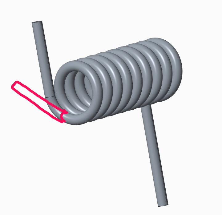

I have a question about how to modify the spring to achieve this:

cut a piece of helical geometry before you add straight end.

*facepalm*  Most.  Ambiguous.  Question.  Ever.

There is no info on how the model is built.  Is it a creo file, or a import feature?  Do you want to actually lessen the amount of coils fractionally, or just hack it off and kludge it as shown?  Are the ends tangent to the helix of the coil, or are they normal to the axis of the spring?  Is the (circular?) cross section normal to the trajectory/helix (the correct way) or normal to the spring axis (distorted ellipse).

This spring has been built using standard helix sweep function where all the ends are laying on the same plane.
Hence my question.
Hence my picture.

If the ends are on the same plane that means the cross section is wrong and the "Through axis of revolution" option is used, instead of being "Normal to trajectory".  When you wind a wire, the cross section will always be normal to the trajectory, that's how the machines actually work.
All you have to do then is modify the number of turns via the pitch (adding pitch points if needed).  It's going to take a bunch of tweaking to get the angle close (not exact).  This is why I don't use helical sweeps because I don't like them.  You can adjust pitch, yes, but you can't control the # of coils, the pitch, and the location of the end points like I want to and can using other methods.spring.jpg

I think another way to get a trajectory is to use Curve from Equation.

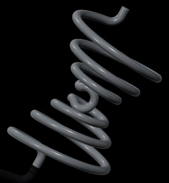

That is one way, for sure, and a good way to force exactly where the ends will be for a spring with a linear pitch.  It's a little cumbersome because you have to orient the CS exactly the way you need it.  Also, if you wanted to, say, create a closed and ground spring, how would you change the pitch only at the very ends?  Or if you needed to reverse the pitch like I've shown?

...aaaand for fun there's this (took me maybe 10min).

For what you're doing, which looks simple with the straight ends tangent to the ends of the trajectory, the curve by equation you mentioned would work better than a helical sweep because you can easily specify the start and end angle.
If you're thinking of doing it by a helical series of points referenced from a CS, don't, you won't get a nice cylindrical profile.
