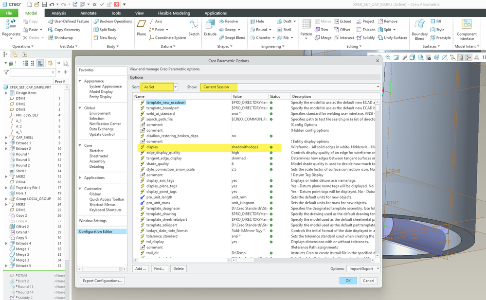

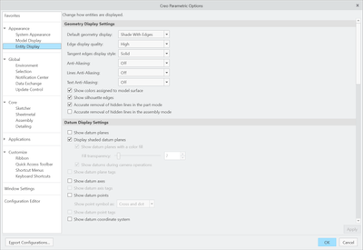

Every time I open the model, the view changes back to "Shaded" even though I have "Shaded with Edges" selected as the default. I'm running Creo 10.

Open the Creo options after you start Creo and check the in session setting of the config option "display". You probably have a config option being read when you start Creo that is causing this, or you have not saved this option to a config that is being loaded when you start Creo. If the option is not set as shown below, then correct this and test the behavior after the change.
Config option:  display shadewithedges

That did it! Thank you!
