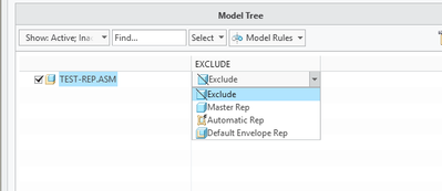

I am using Creo 11.0 I have multiple Simp Rep in assembly for example S1, S2, S3 and S5. Now I am assemble one more part and create one more sim rep S6. So, S6's part automatically added in all existing representation. Now my problem is that how can I exclude S6's part from all existing easily.

Once created, there is no "easy" way to exclude one part from all other simplified reps, if the original reps were created as "master rep".
When you create a new simplified rep, you have an option to create the rep as an "Exclude" rep. All component added to the assembly are "excluded" except those components specifically set to master rep.
If a rep is created as a "master rep", then all components added to the assembly are "Included" except those components that you specifically exclude.
Note: "Master Rep"used to be called "include" rep.
